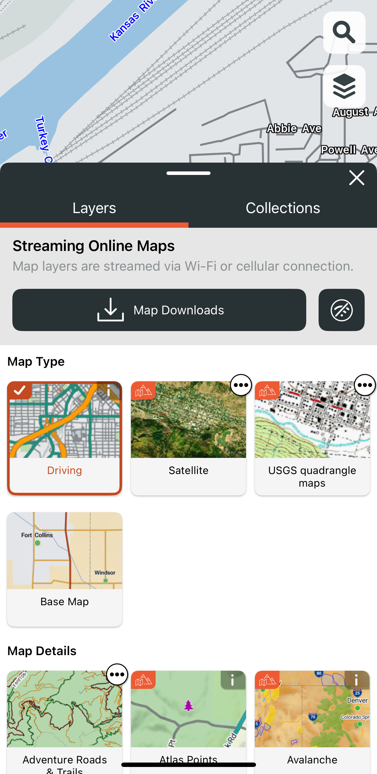

Adding Map Layers
When selecting Map layers in the Tread app, there will be a Map Type, and Map Details. A Map Type is the main map being displayed. Map Details are additional layers of data on top of the selected Map Type, allowing for more customization of map visuals.

To Change the Map Layers
1. Touch the Map Layers icon
2. Select the Map Layers you wish to add
 Choose map layers
3. If desired, toggle between online and offline maps by selecting the offline icon
