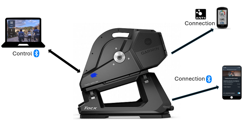

Connection Versus Control
The Tacx® NEO 3M smart trainer is capable of both being connected to and controlled by a variety of devices. Understanding the differences can help with troubleshooting connection.
Connection
The trainer is able to be connected to multiple devices in order to share its data such as power, speed, distance, etc. When a connection is established to a device such as an Edge® cycling computer or training app, the trainer is simply transmitting the data and the connected device has no dictation on the resistance or road feel of the trainer.
Connection Types:
  • Bluetooth Low Emission: Up to 2 connections allowed
  • Wi-Fi/Ethernet: One connection allowed
  • ANT+: Multiple connections allowed
Control
When the trainer is controlled, it is not only sending information back to the paired device, but the device can change the trainer's resistance, change the road feel, or setting the rider's simulated weight.
Protocols used for Control:
  • FTMS (Fitness Machine Service Protocol)
    • Preferred method for Tacx trainer road feel and weight
    • Available via BLE and Ethernet/Wi-Fi
  • FE-C
    • Standard for ANT+ control

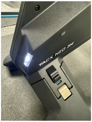

White LED
The trainer is on, but not being controlled.
White LED on neo 3M

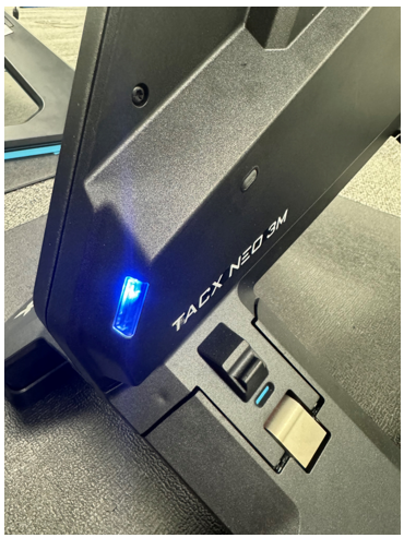

Blue LED
A BLE connection has control of the trainer.
BLE LED light on NEO 3M

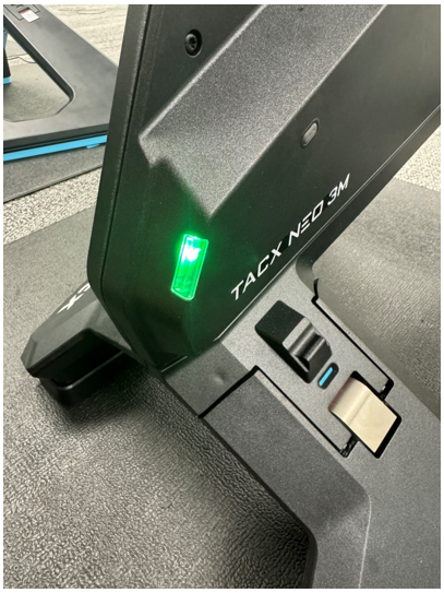

Green LED
An ANT+ device has control of the trainer. A green LED will also indicate that an ANT+ device was the last to control a trainer if the control has ended. This is because the trainer is still using the settings last set by the ANT+ device instead of defaulting back to 0% slope.
green LED on neo 3M

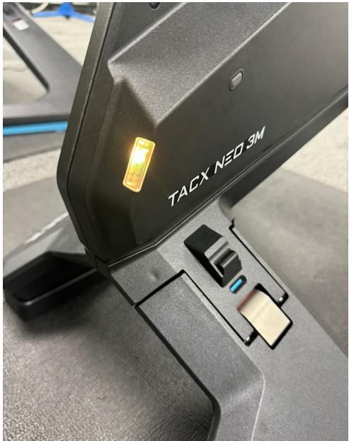

Yellow LED
An ethernet or Wi-Fi connection has control of the trainer.
yellow LED wifi control on 3m
Example of Controlled NEO 3M With Multiple Connections
control vs connect on tacx neo 3m

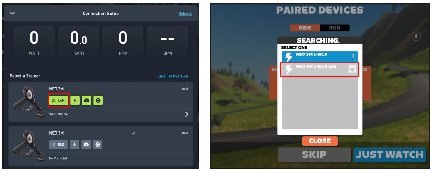

Ethernet/Wi-Fi Control
Ethernet/Wi-Fi Control requires an additional accessory: the Tacx® Smart Network Adapter. Refer to this FAQ to set up the Network Adapter. To troubleshoot Ethernet/Wi-Fi control:
    • Ensure the training app is using the same Wi-Fi network the trainer is using.
    • Ensure the trainer is connected to power while using the Network Adapter.
    • Control over Wi-Fi/ethernet will not work behind VPN or certain firewalls such as workplace or hospitality environments.
    • In the training app, the NEO 3M will show up as two connection options , one for BLE version and one for the Network version. Ensure you are selecting the network version.
wifi and ble showing in tacx and zwift apps
