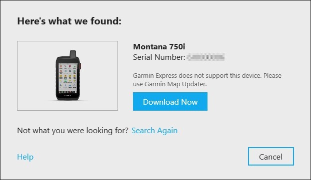

If there is an issue communicating with an outdoor handheld device, the Garmin Express™ program may display a message that the device is not supported and to use either Map Updater or WebUpdater instead, even if the handheld is actually compatible with Garmin Express.
Garmin Express does not support this device. Please use Garmin Map Updater.
Garmin Express Does Not Support This Device
