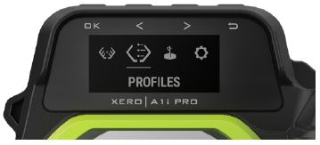

The image below shows the icon for Arrow Profiles in the Xero® A1i PRO bow sight's menu.
Arrow Profiles Menu
