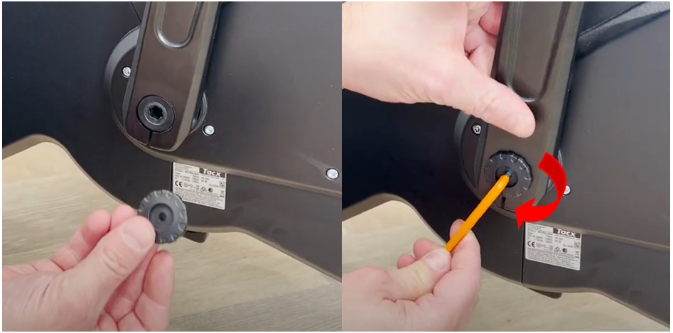

1. Remove Pinch Bolt
On the non-drive side crank arm, remove the pinch bolt using a 5mm Allen wrench.
remove pinch bolt with 5mm allen key

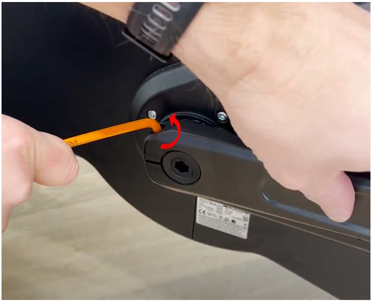

2. Tighten Crank Bolt
Use the bracket cap removal tool to tighten the crank bolt to approximately 2.5 Nm.
Tighten Crank Bolt with bracket cap

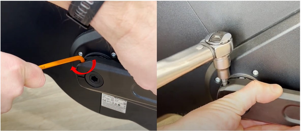

3. Re-install Pinch Bolt
Re-install your existing pinch bolt with thread lock, or the new pinch bolt with pre-applied thread lock. Tighten to 22 Nm.
tighten pinch bolt with allen key
