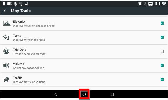

 It is possible to add 3 additional data fields on the map by enabling the Trip Data map tool on the device.
To Enable Trip Data:
1. Touch the Settings wheel
2. Touch Navigation
3. Touch Map & Vehicle
4. Scroll down and touch Map Tools
5. Touch the box next to Trip Data to enable it
    • Trip Data is already enabled if a checkmark is in the box
7. Touch the circle on the bottom of the screen to return to the main menu screen

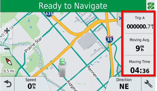

8. Touch View Map
9. Touch the wrench in the lower right corner
10. Touch Trip Data
Three additional data fields will appear on the right side of the screen. You can customize these by touching any one of them, and touching the + icon next to the desired data type.
