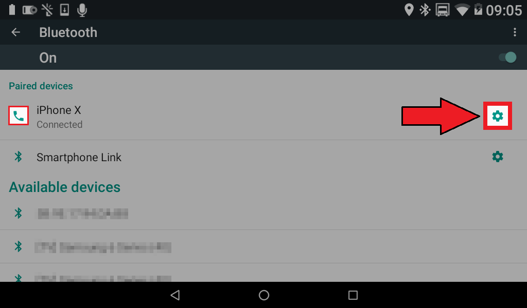

3. Next to the device you wish to delete, touch the Android settings gear gear icon
Android - Bluetooth - device options

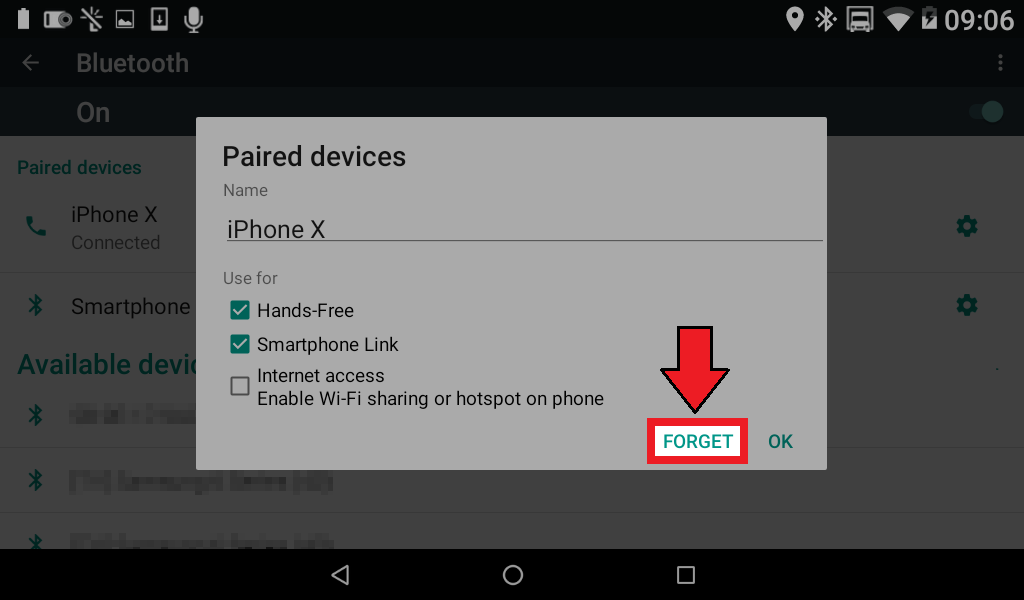

4. Touch Forget
Android - Bluetooth - forget device

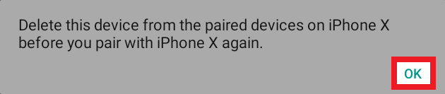

5. Touch OK
Android - Bluetooth - confirm forget
  • If the headset is also paired to your phone, we recommend clearing the pairing history for this device on your phone as well.
