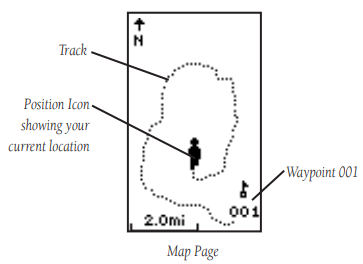

Viewing the Map Page while Moving
  1. Use the PAGE button to access the Map Page and view the new waypoint.
  2. Press the DOWN button to zoom in for a more detailed view of the map.
  3. Walk or drive around for a few minutes, make a right or left turn, then continue for a few more minutes and then stop.
    NOTE: The 'Position Icon' shows your location and the dotted line shows your path of travel, called a Track.
    Map Page

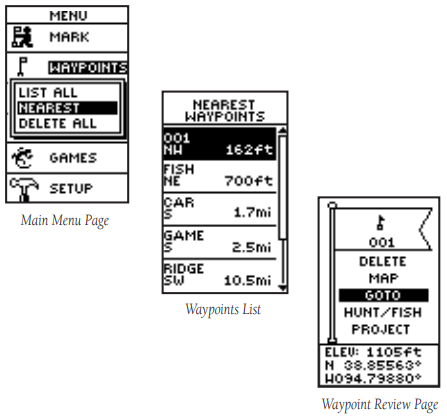

Return to a waypoint Using Goto
    1. Press the PAGE button a few times until the Menu Page displays.
    2. Use the UP or DOWN button to highlight 'Waypoints' and then press the OK button.
    3. Use the UP or DOWN button to highlight 'Nearest' and then press the OK button.
    4. Use the DOWN button to highlight the waypoint and then press the OK button to display the Waypoint Review Page.
    5. With the on-screen 'GOTO' button highlighted, press the OK button to activate the Goto navigation feature.
      NOTE: The Navigation Page automatically displays, and the remaining distance to your destination is shown at the top of the page.
      Return to a Waypoint Page Options
