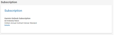

  3. Go to Subscription in the Menu on the right side of the screen
    OnDeck Subscription Panel In ActiveCaptain
    • Active subscriptions will display in the overview
  4. Select Details for the subscription intended to be transferred

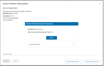

  5. Select Edit Subscription
    OnDeck Edit Subscription Option
  6. Select Transfer Subscription
    OnDeck Transfer Subscription Option
  7. Enter the IMEI number for the OnDeck device to transfer the subscription to
    Enter IMEI and Confirm Transfer of OneDeck Subscription
  8. Select Transfer Subscription in order to complete the transfer
