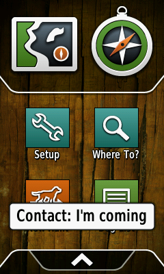

Receiving a Message
When receiving a message on the Alpha 100 you will get a message prompt on the screen as seen below.
Alpha received message
Note: On the Alpha 100 you can not view a message after it has been received and prompted on the display.
