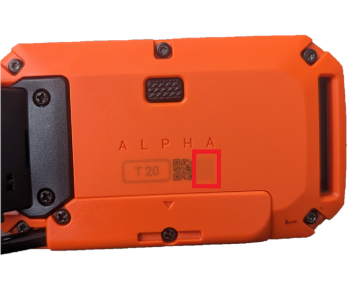

Finding the Serial Number on the Dog Collar
The serial number is located on the back side below the power button.
Serial Number t 20

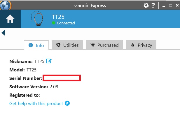

Using Garmin Express™ Program to Locate Your Serial Number
Another way to get the serial number from your tracking and training collar is using the Garmin Express program to electronically retrieve the serial number using your compatible computer. To start you will need to download the Garmin Express program here, Garmin Express. Once installed and opened,
  1. Using the supplied USB cable and collar clip connect the device to your computer.
  2. If this is the first time you are using Garmin Express select Add Device follow the prompts to continue.
  3. If your device was previously added select the device tile.
  4. Select Tools & Content.
  5. You will find the serial number listed un the Info tab.
Alpha TT 25 serial number
