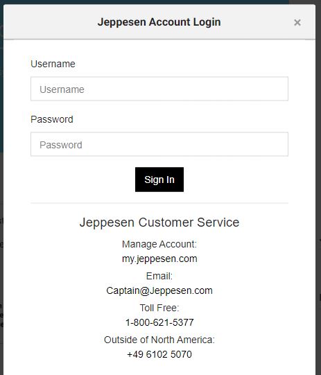

      1. Home >Settings > Jeppesen
      2. Log into Jeppesen account.
    3. Select a license to activate. The tail number in Jeppesen must match the tail number of the aircraft in flyGarmin.
    4. Activate the license and download all the Jeppesen database files to the portable device.
