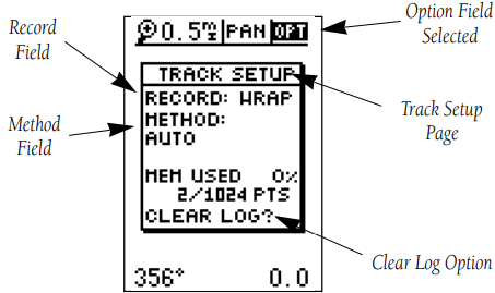

The track setup page lets you manage the GPS 12/12XL's track log data. you can also select whether to record a track log and define how it is recorded.
Track Setup
  1. From the Map page got to OPT, and press ENTER.
  2. Go to 'TRACK SETUP', press ENTER.
  3. To turn the track log on or off, highlight the 'RECORD', and press ENTER.
  4. Select 'OFF', 'FILL', or 'WRAP', and press ENTER.
    NOTE: Turning the track recording off will prevent you from using TracBack® routing feature.
Track Setup Image
