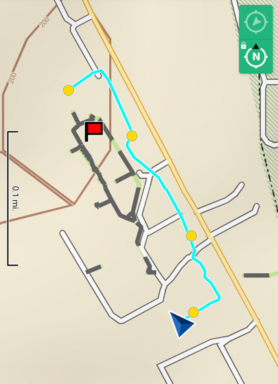

Example of Tracking in the Earthmate App With a Paired inReach Handheld
The log points show as a blue line and the send points show as yellow dots.
Earthmate for Android Track Example
NOTE: While actively tracking, the tracking page only shows a straight line between the yellow send points. To view the detailed log interval line while actively tracking, switch to the map page.

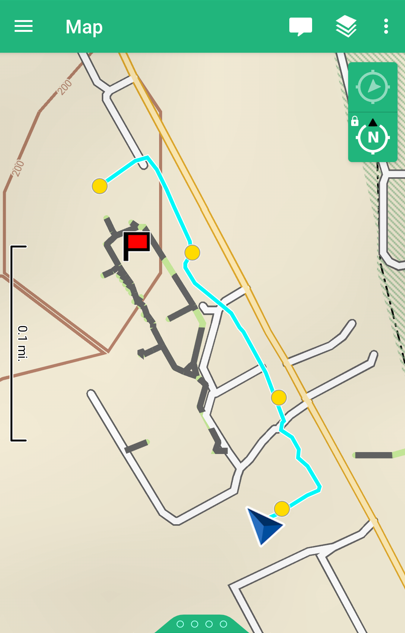

Earthmate for iOS Track
