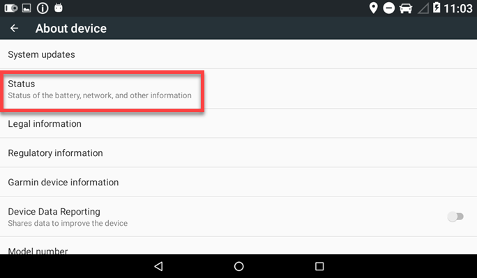

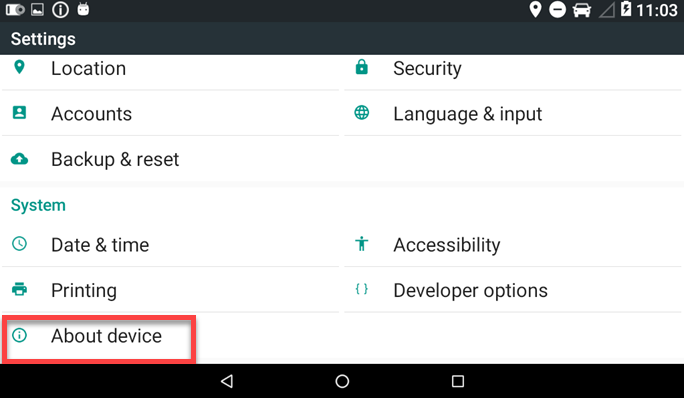

2.  Scroll down and select About device
about device

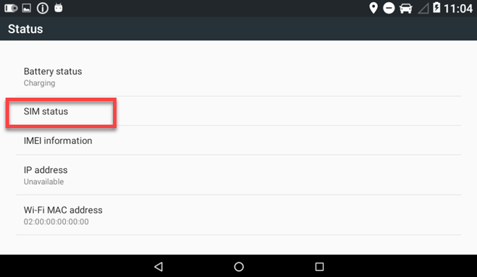

4.  Select SIM status
SIM status

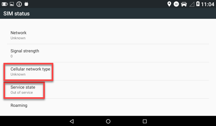

If Service State and/or Cellular network state show Out of service and/or Disconnected, contact your SIM provider
Service state

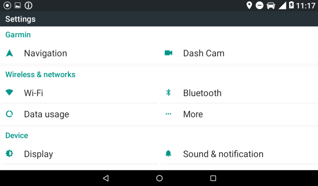

2.  Select Data Usage
Data usage

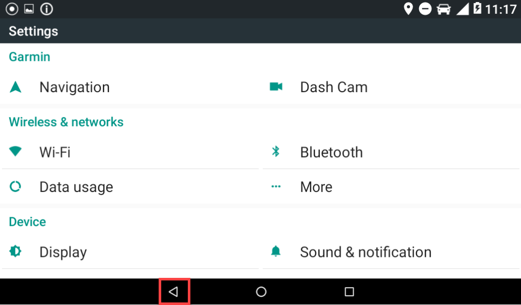

4.  Select the Back arrow if the device has Cellular Data enabled
Back1

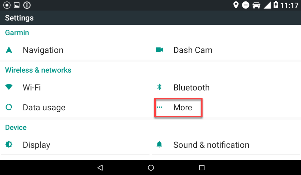

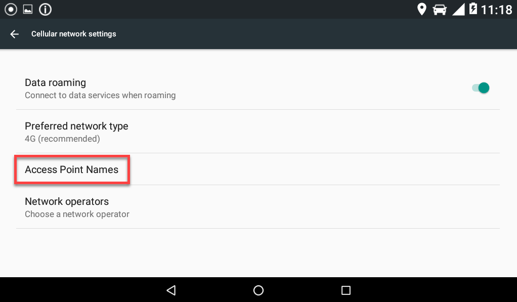

5.  Select More
More

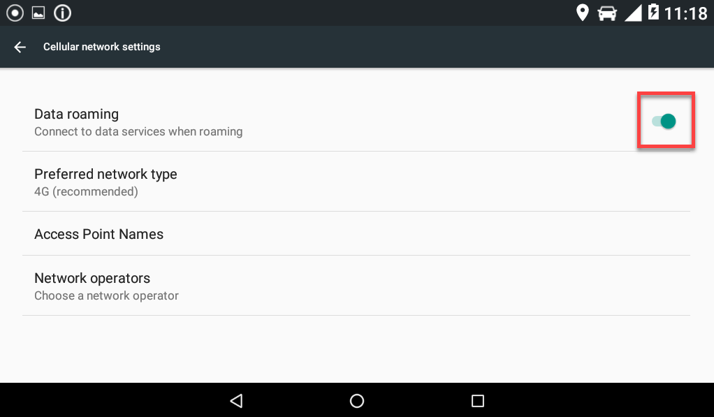

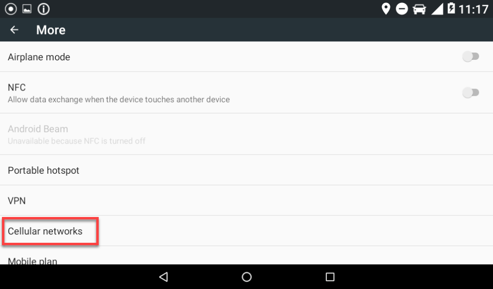

6.  Select Cellular networks
cellular networks

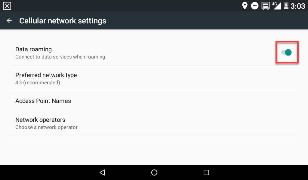

7.  Verify Data roaming is enabled
Data roaming

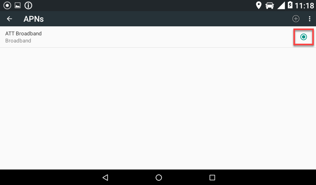

8.  Select Access Point Names if Data roaming was enabled
Access Point Names
9.  Verify the Access Point Name is correct and selected
APNs

2.  Select About device
about device

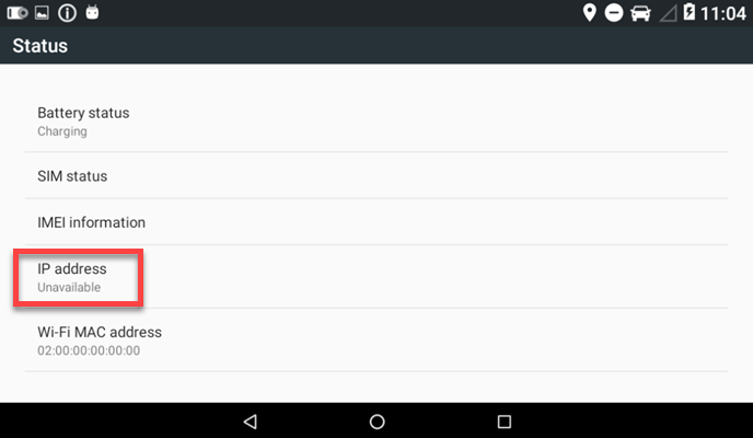

3.  Select Status
status2
4.  Verify the IP Address displays information
IP address
