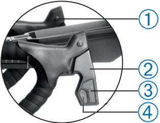

The bike levers on your NEO Bike Smart Trainer mimic what you would find on a real bike. They buttons that offer a rider options when riding. Below is a breakdown of what each bike lever offers.
Break Lever Functions
neobike brake lever one with circle Control buttons that control a variety of settings when pressed including metrics and training modes.
two with circleBrake levers that will slow the spinning of the rear disc.
three with circlePressing this button shifts you up a virtual gear. Use the left shifter to change the gears on the front and the right shifter to change the gears on the rear.
four with circlePressing this button shifts you down a virtual gear. Use the left shifter to change the gears on the front and the right shifter to change the gears on the rear.
