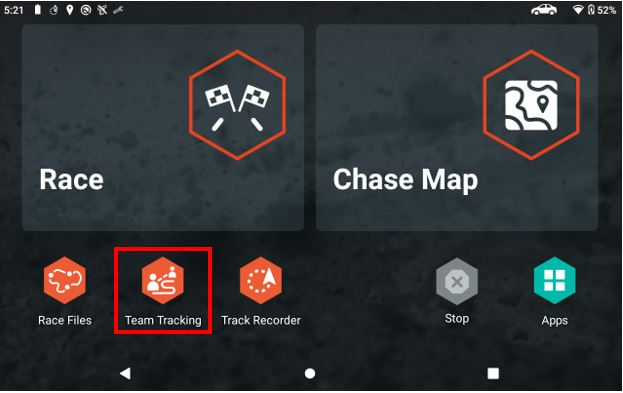

1. Touch Team Tracking

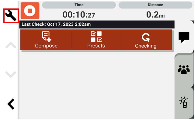

2. Touch the Wrench Icon

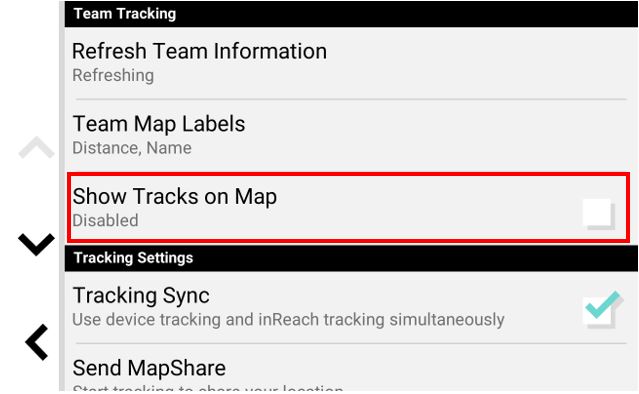

3. Touch Show Tracks on Map
When viewing your teammate's track, it will not be the exact path. A straight line is drawn between the points based off of the tracking interval.
