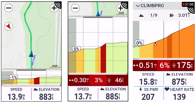

What Information Will ClimbPro Display During My Ride?
ClimbPro features two unique modes to display information, as described below. Information shown can vary between Edge models. Refer to your owner's manual and search for "ClimbPro" for details.
During a Climb
At the start of a climb, the ClimbPro screen as shown below will appear automatically. As you are completing each climb segment, the profile of the climb will become more detailed. The information that the screen will display includes:
  • The number of the climb including total climbs for the course.
  • The distance remaining in the climb.
  • The ascent remaining for the climb.
  • A chart showing the profile of the climb.
    • The Pin icon icon or white bubble represents where you are currently at on the climb.
  • The average grade for the climb.
  • Configurable data fields (defaults are Grade and Elevation).
  • Map overview (Edge 1050 only).
    • Swipe up or down on the elevation profile to change the configuration of the screen as shown below.
Edge 1050 ClimbPro screen configurations showing the map and elevation profile

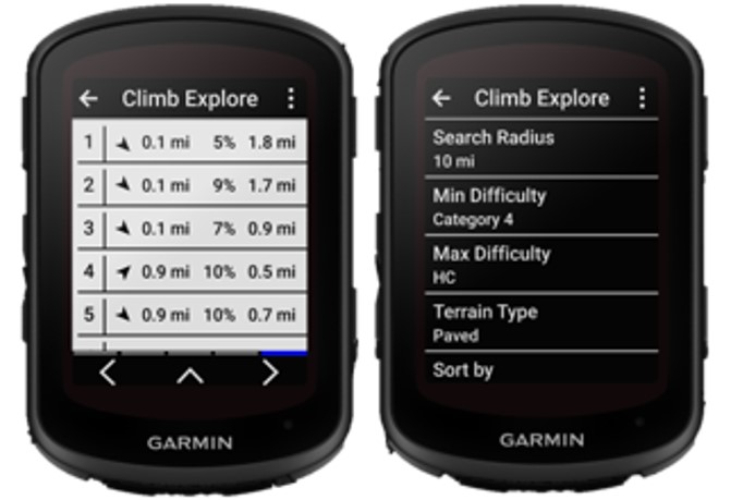

Navigation Free ClimbPro
The Edge 540/840/1040/1050 Series and Edge MTB can show nearby climbs without following a course. You can find nearby climbs on your Edge using the Climb Explore widget or by panning the map. Refer to ClimbPro: Tethered Versus Free Climbing for more information about this feature.
screenshot of climb explore widgets
