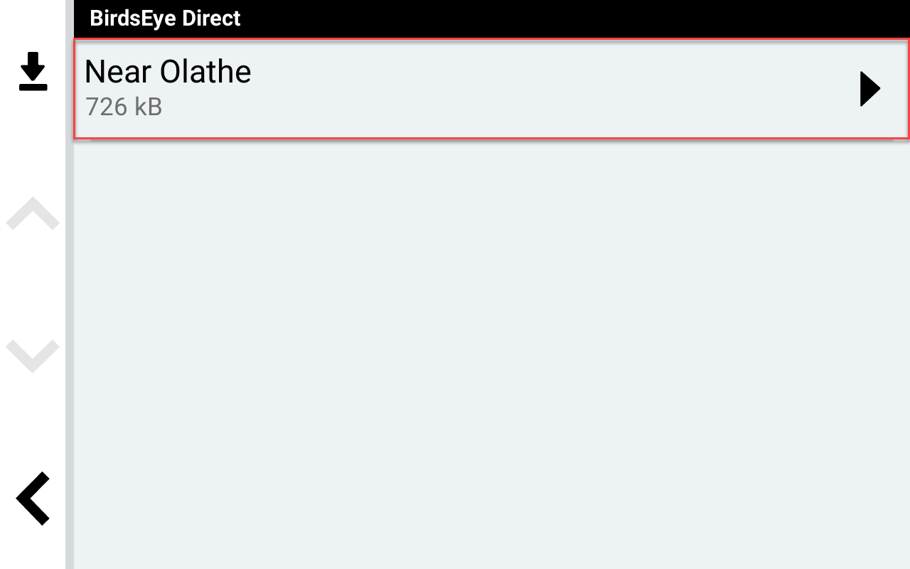

To View Downloaded Satellite Imagery in the BirdsEye Direct App:
1. Touch Apps
2. Touch BirdsEye Direct
3. Touch the name of the BirdsEye Imagery download you wish to view
4. Birdseye Imagery is then shown with information on file size, storage location, and detail level.
