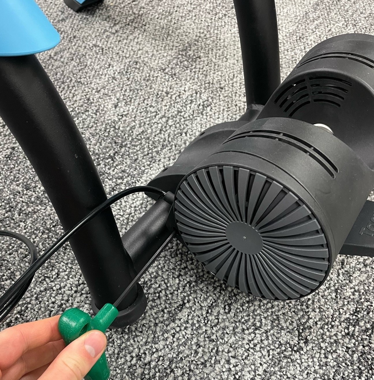

Step 1: Remove Resistance Unit Cover
  1. Using a Torx T20 screwdriver, remove the screw holding the resistance unit cover to the resistance unit.
    Cover Screw on Boost Resistance Unit being removed with tool
  2. Pull the cover away from the resistance unit to remove it.

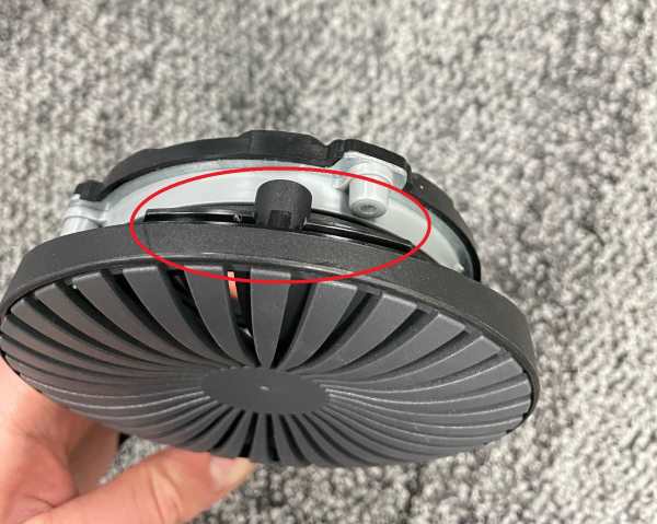

Step 2:Install Replacement Resistance Unit Cover
  1. Locate the protruding tabs on the resistance unit cover and their corresponding indents on the resistance unit.
    Resistance cover tab circled in red
  2. Align the tabs with the indents, and fit the cover onto the resistance unit until it is flush.
  3. Install the screw, tightening until the cover is securely fastened to the resistance unit and cannot be pulled away.
  4. Adjust the resistance lever to ensure it cycles through the full adjustment range.
