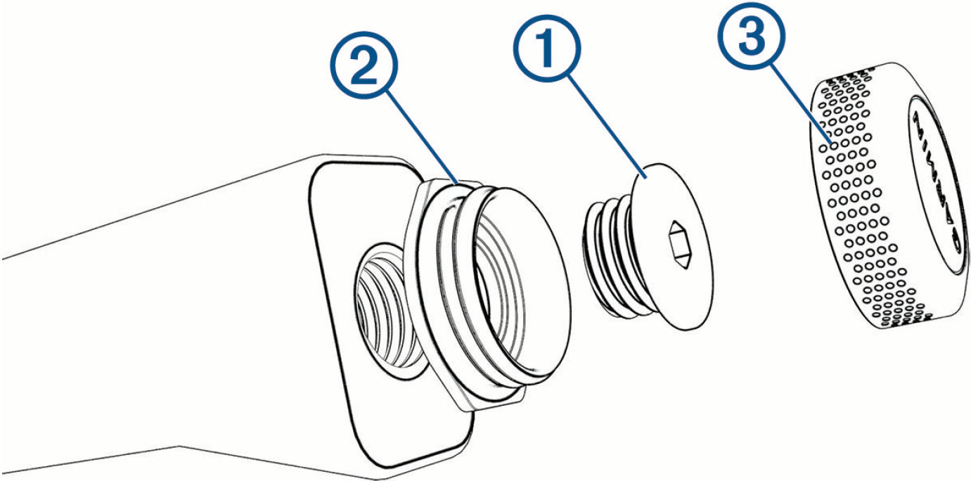

Approach CT1 - SuperStroke Edition
  1. Using a 4 mm (3/16”) hex wrench, remove the screw on the end of the SuperStroke grip Circle with number one inside.
    Golf club grip installation with cap and parts
  2. Unscrew the lower housing Circle with number two inside from the Approach CT1 - SuperStroke Edition tag Circle with number three inside.
  3. Secure the housing to the end of the grip using the SuperStroke screw and hex wrench.
  4. Screw the device onto the housing.
    NOTE: Ensure that the device is fully tightened onto the end of the grip. There is a small notch in the housing that should line up with a notch in the device when it is fully tightened.
