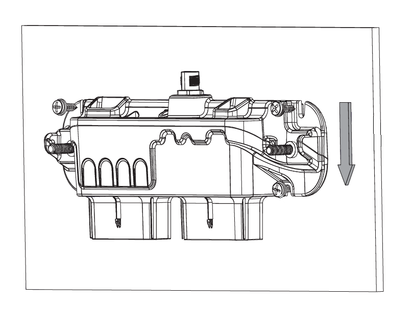

Garmin Boat Switch Installation Positioning

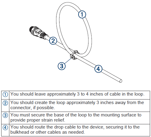

When installing the Garmin Boat Switch, it must be mounted in a location where it will not be submerged and in such a way that water will not pool within the plugs. The X1 and X2 harness plugs must point down and a service/drip loop must be created in the NMEA 2000 drop cable to prevent water intrusion.
For more information on NMEA 2000, see Technical Reference for Garmin NMEA 2000 Products Installation Instructions
Boat Switch Installation Diagram NMEA 2000 Service Loop
