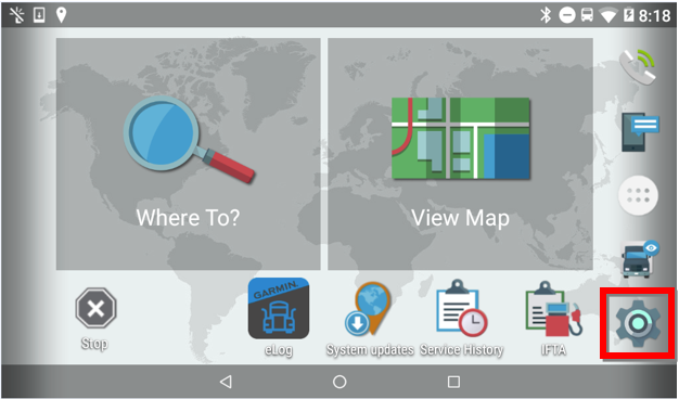

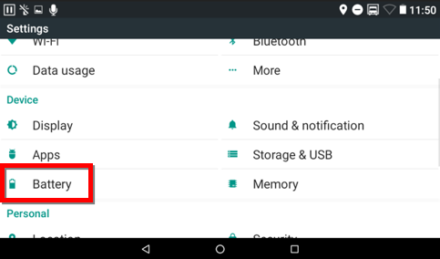

1. Touch Settings

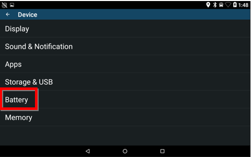

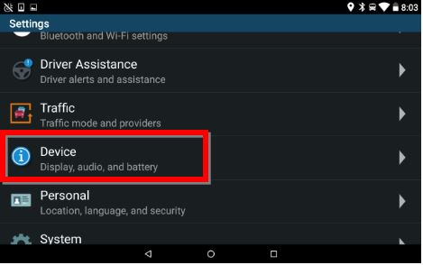

2. Touch Device

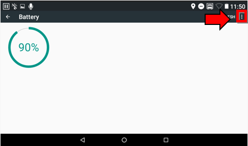

3. Touch Battery

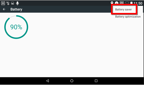

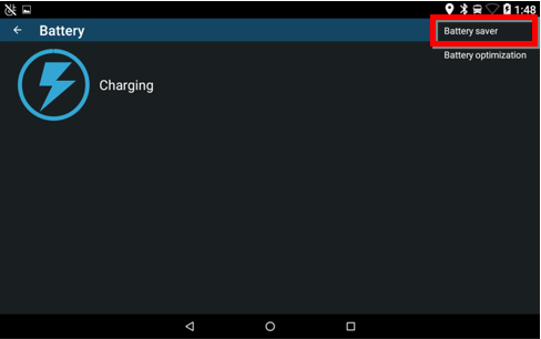

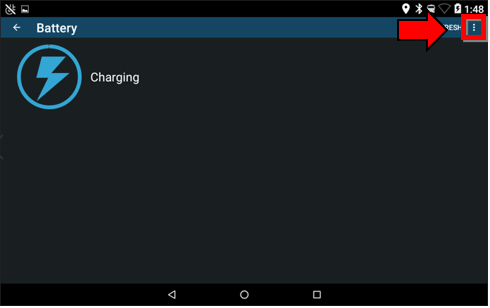

4. Touch the 3 dots in the top right corner
5. Touch Battery Saver

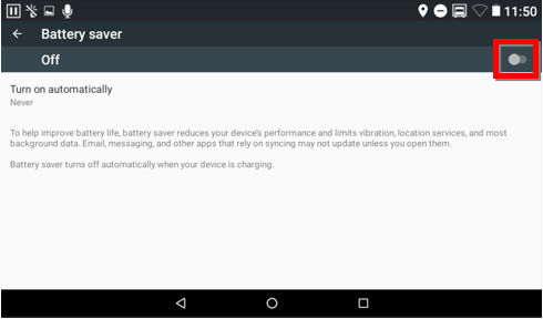

6. Toggle Battery Saver Off

1. Touch the settings wheel overlander® settings icon or
2. Touch Battery
3. Touch the 3 dots in the top right corner
4. Touch Battery Saver
5. Toggle Battery Saver Off
