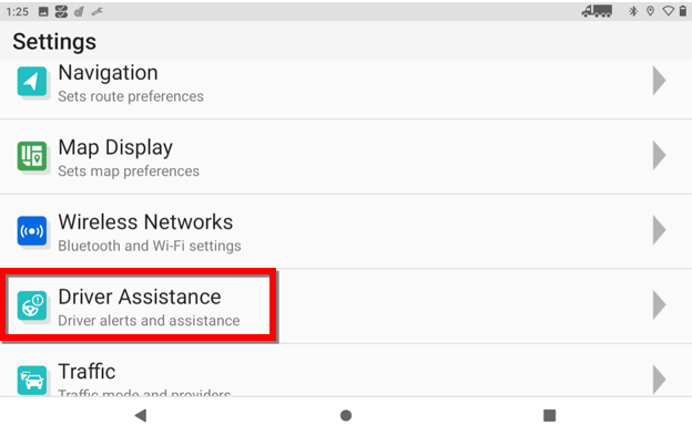

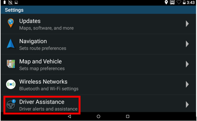

1. Touch Settings

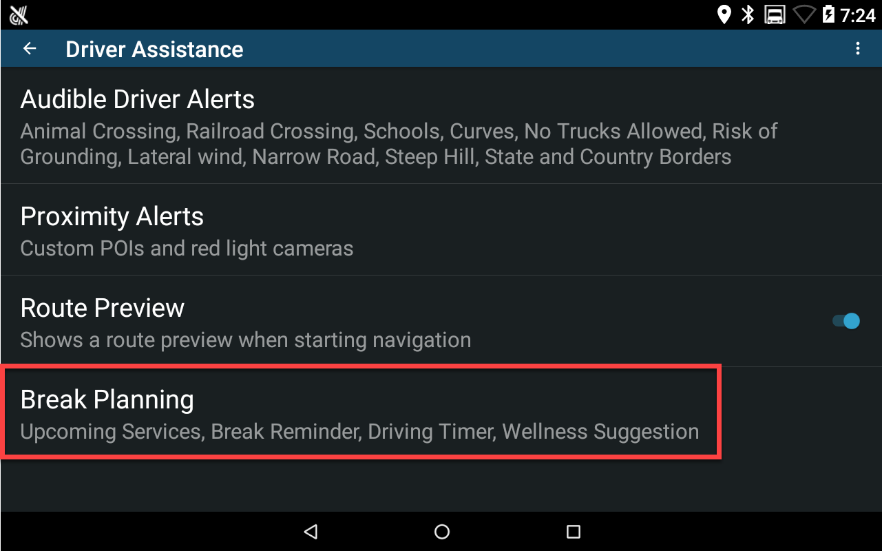

2. Touch Driver Assistance

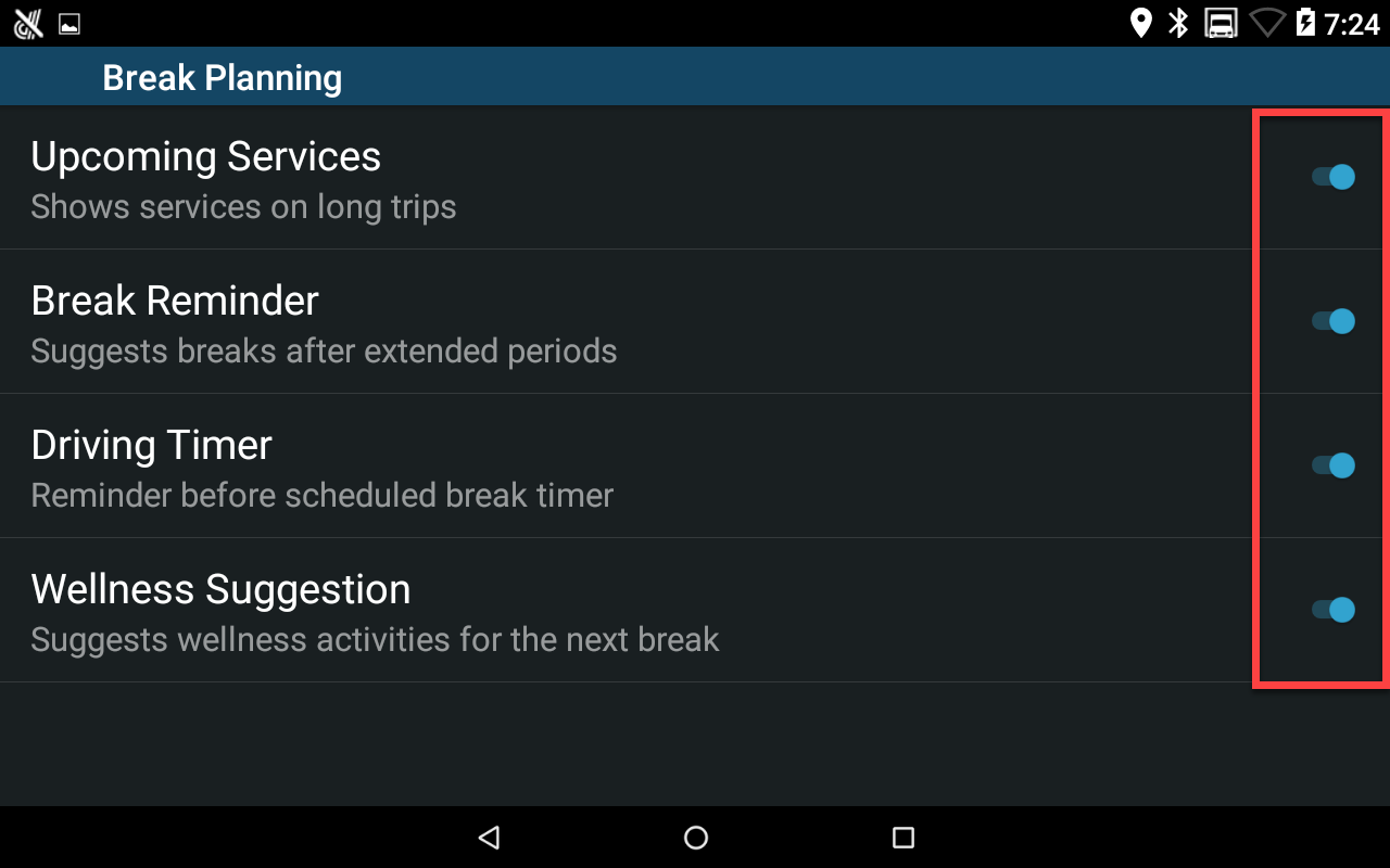

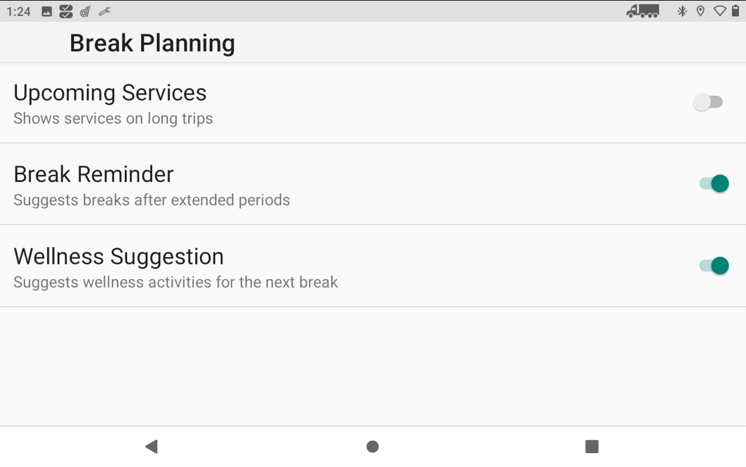

3. Touch Break Planning
4. You can enable/disable the following options
  • Move the toggle switch to the right to enable, or left to disable.

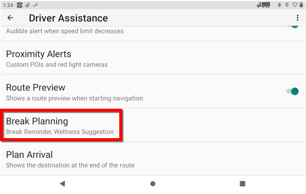

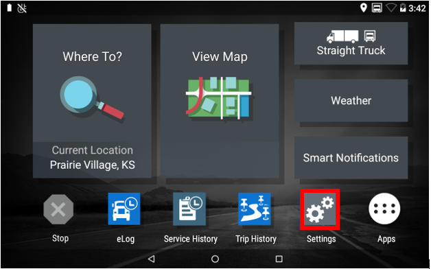

dēzl™ OTR610, dēzl™ OTR620, dēzl™ OTR710, dēzl™ OTR720, dēzl™ OTR810, dēzl™ OTR820, dēzl™ OTR1010, dēzl™ OTR1020 GPS Navigators, dēzlCam™ OTR710, or dēzlCam™ OTR725 GPS Navigators With Camera:
1. Touch Settings

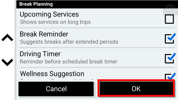

  • For the dēzl OTR610, dēzl OTR620, dēzl OTR710, dēzl OTR720, dēzl™ OTR820, dēzl OTR1020, dēzlCam OTR710, or dēzlCam OTR725, touch the box to add or remove a checkmark and touch OK.
  • For the dēzl OTR810 and dēzl OTR1010, move the toggle switch to the right to enable, or left to disable.
A list of suggested Points of Interest (POIs) will appear along your route where you can take a break when a HOS stop is required. Select one of these POIs to add it as the next stop on your route.
