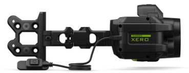

Xero A1/A1i Bow Sight Mount Attachment
The mount for the Xero A1/A1i bow sight is attached to the support. The mount is attached directly to the frame of the bow.
Xero Ai1 Mount Side View
