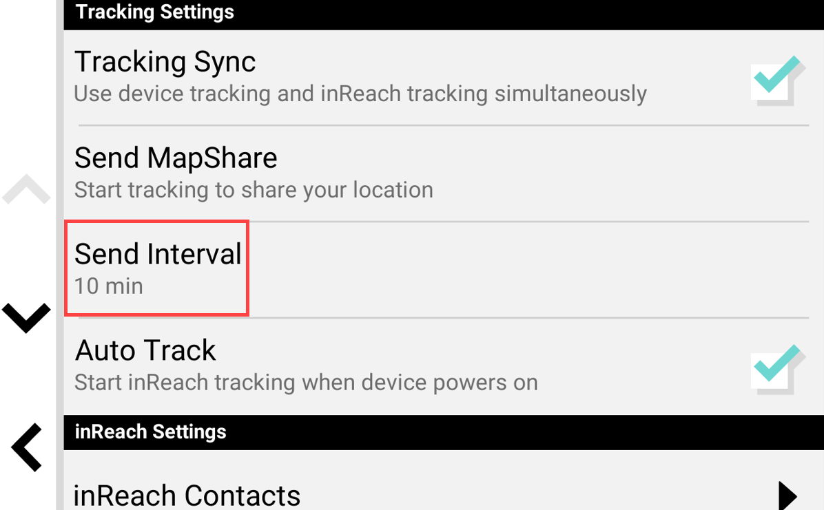

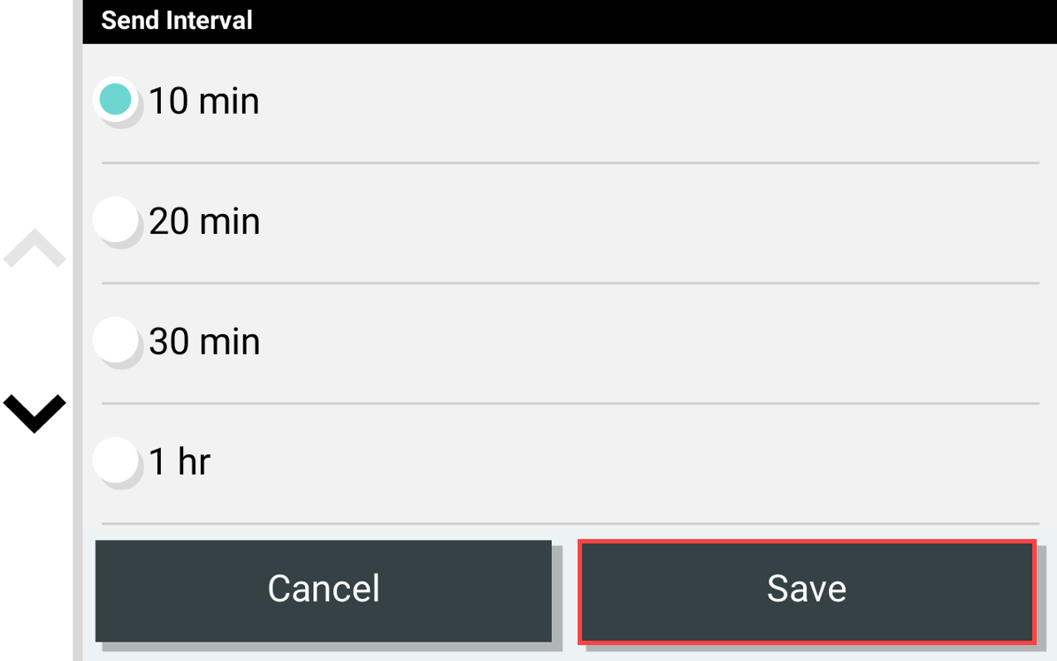

  3. Touch Send Interval.
    Example of Track Settings
  4. Select a Send Interval option and touch Save.
    Example of Send Interval Options and Save Button
IMPORTANT: With the Safety,1 Enabled, and Essential plans, there is an additional cost per point (varies by currency) using the Send Interval. As an example, if your Send Interval is set to 10 minutes and you had tracking on for 1 hour, you could be charged for 7 track points (this includes a starting track point). For more details, see - inReach Satellite Subscription Plan Pricing and Global Availability FAQ.

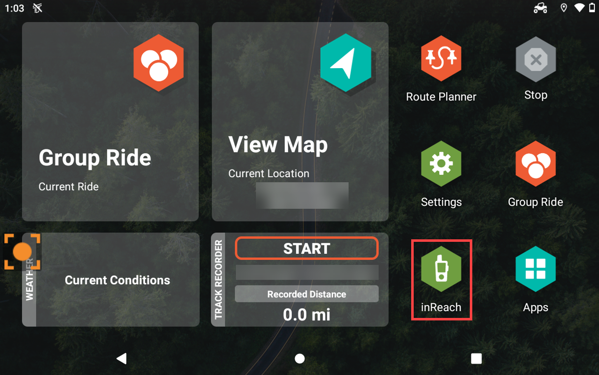

  1. Touch inReach from the main menu.
    Example of Main Menu
  2. Touch the Tracking icon in the top left.

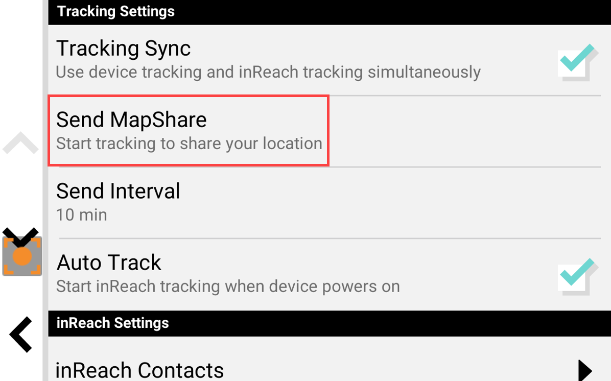

    OPTIONAL: Send your MapShare link to recipients to allow them to follow along your track. This counts against your plan's monthly message allotment. If your plan does not have unlimited messaging, this can result in additional costs once your allotment is used up ($0.50 USD/each message). Send MapShare only counts as one message regardless of how many recipients are entered, but if recipients reply, each reply counts against the allotment.
    1. Touch the Wrench icon.
      Example of Wrench Icon
    2. Touch Send MapShare.
      Example of Tracking Settings

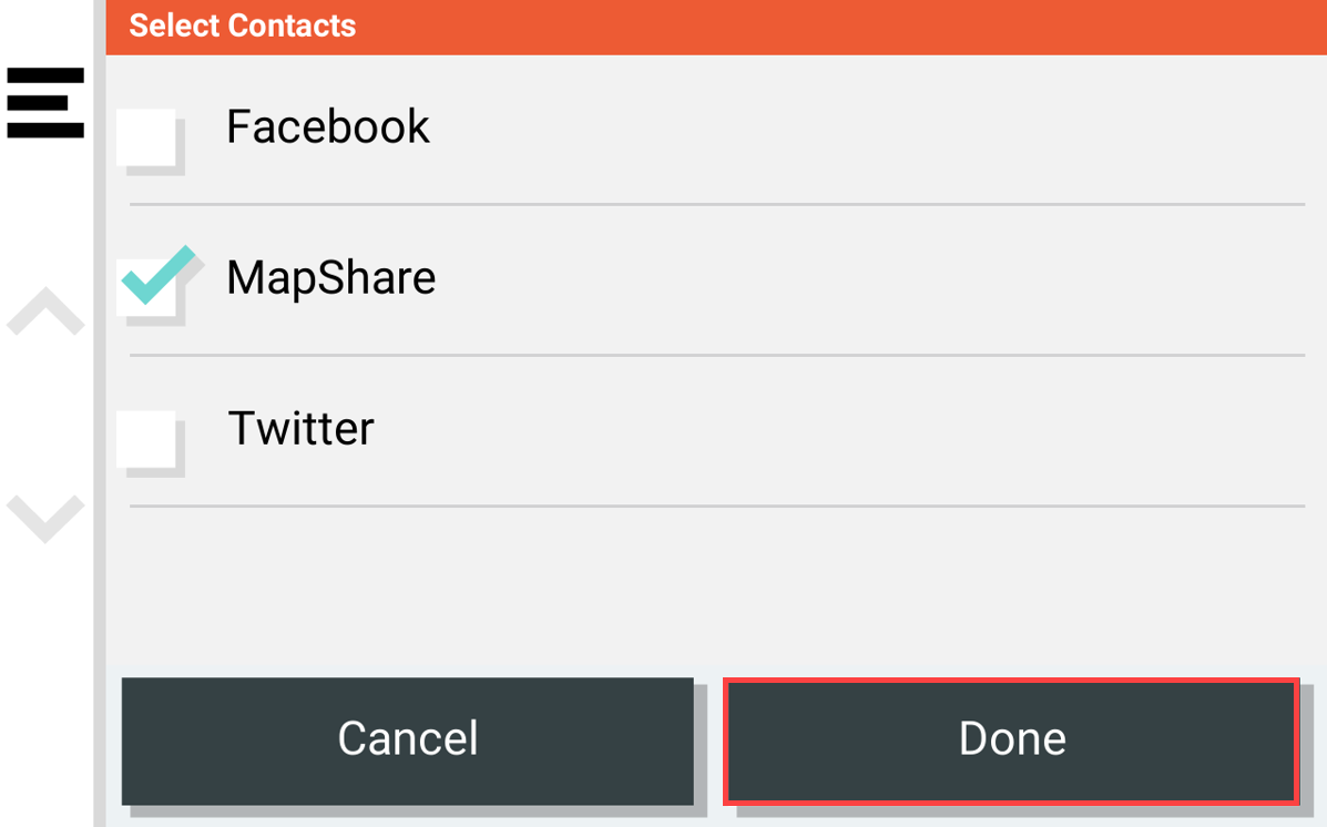

    3. Touch the menu button followed by Type Recipients to manually enter contact information, or select from the list of available contacts.
      Example of Contacts List
    4. Touch Done when finished.
      Example of Done Button

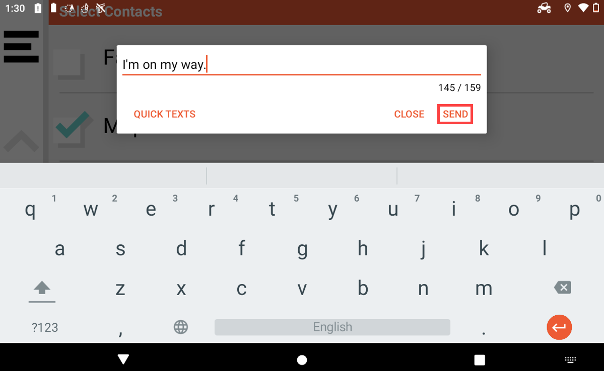

    5. Use the keyboard to enter a message and touch Send.
      Example of Keyboard and Send Button

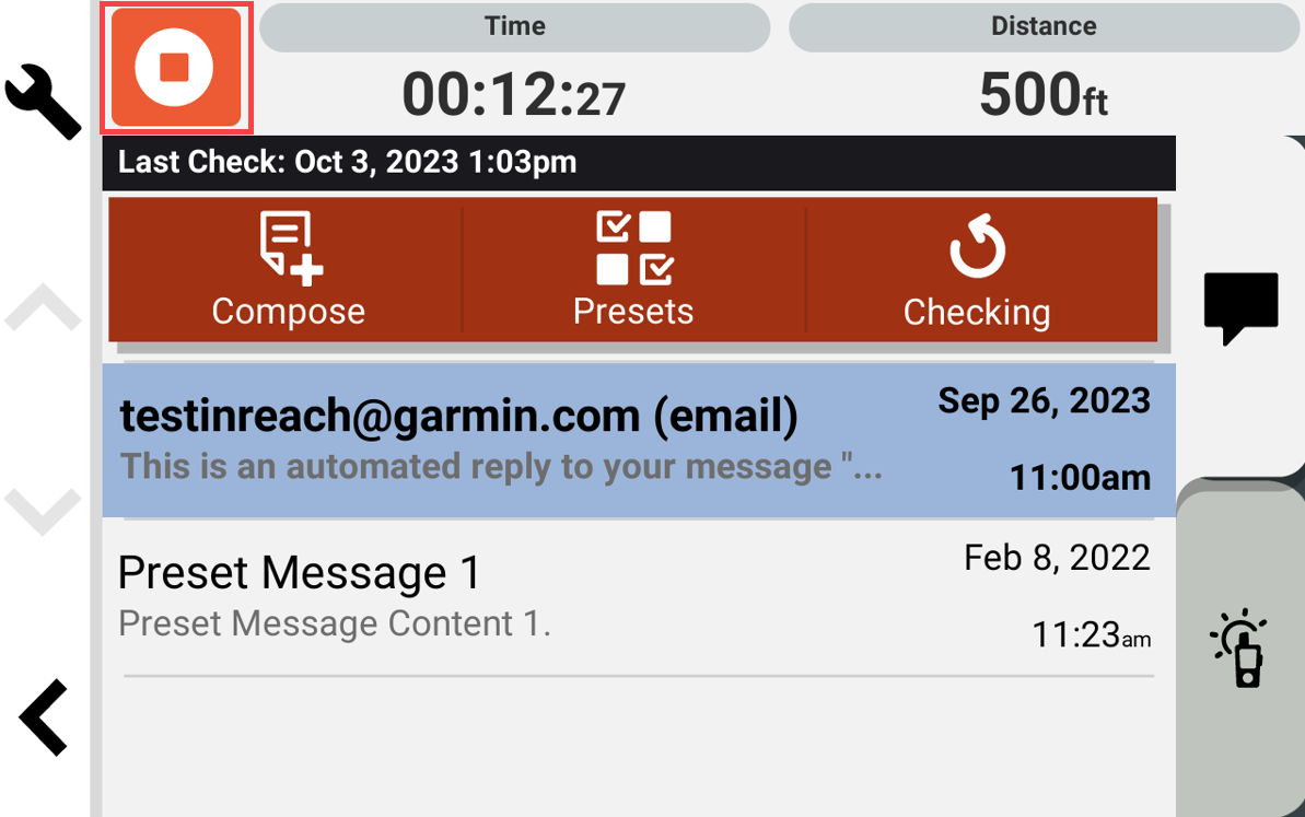

Stopping Tracking on the Tread Device
When you are done recording your track, you can stop it with the steps below.

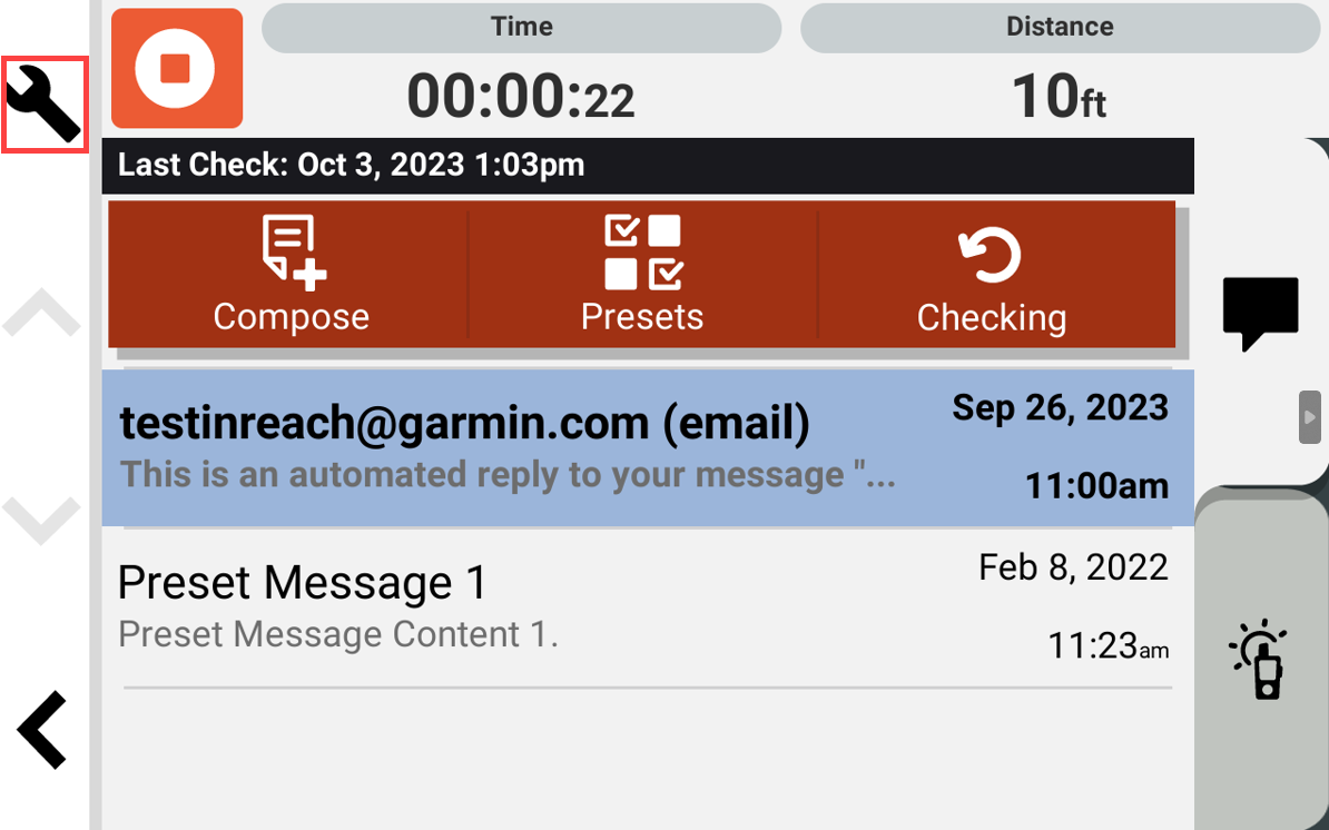

  2. Touch the Stop icon.
    Example of Stop Icon

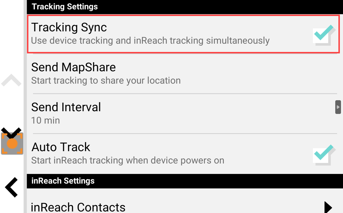

The Tread devices have a feature allowing you to link inReach tracking with the Track Recorder. With this setting enabled, starting/stopping the Track Recorder will also start/stop inReach tracking automatically.
Enable or Disable Tracking Sync
  2. Touch the wrench icon.
  3. Touch Tracking Sync to enable or disable the setting.
