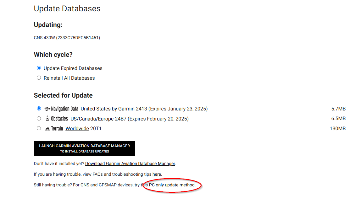

  1. On fly.garmin.com, navigate to the GNS unit you wish to update.
  2. Below the button "LAUNCH GARMIN AVIATION DATABASE MANAGER," click on the link PC only update method.
    • PC only Update
