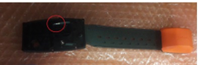

This content provides detailed information on the VHF antenna repair of your T 5 Dog Device or TT™ 15 Dog Device.
