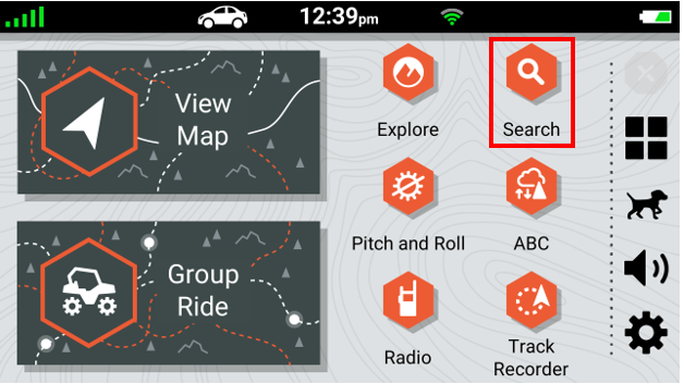

1. Touch Search

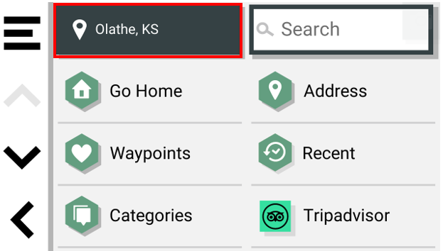

2. Touch the location icon
3. Touch Upcoming Exits
