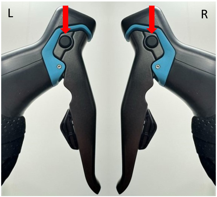

Entering Customization Mode
To enter the mode to customize the display, click the control buttons on the inside of the right and left shifter at the same time:
right and left neo bike control buttons

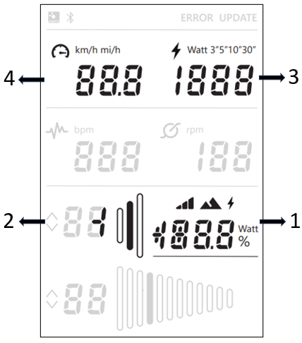

While in customization mode pressing both buttons add the same time will cycle through the different fields. Once you have the field/setting you want to customize selected, select either the right or left button individually to cycle through the available options.
neo bike display data fields
Field/Setting Options
Simultaneous Left + Right ClicksDisplay Data
1Option to show resistance, slope, or power training mode. See table below for icon reference.
2Usually this icon will reflect the front gear, however in this mode it represents the fan speed between low, medium, or high.
3Power watts in current, or 3, 5, 10, or 30 second averaging.
4Speed in kilometers or miles per hour
