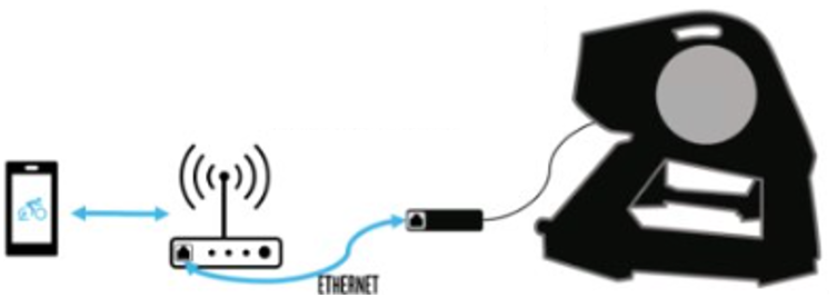

To Connect Via Ethernet
  1. Plug the Network Adapter into the trainer.
  2. Plug your ethernet cable directly into the Network Adapter.
  3. Open the Tacx Training™ App.
  4. Select Settings.
  5. Select Device Manager.
  6. Confirm the trainer is connected via ethernet.
    NOTE: Below is an example of a trainer that has been paired via wi-fi before, but is paired via ethernet currently:
    3M connected via ethernet in the tacx app

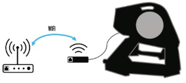

Wi-Fi connected to Network Adapter
3m connected to wifi first step
Blinking green continuously

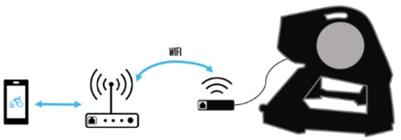

Wi-Fi connected to training app and Network Adapter
app trainer and wifi all connected
Solid green

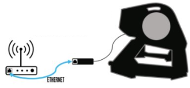

Ethernet connected to Network Adapter
3m and ethernet connection step 1
Blinking blue continuously

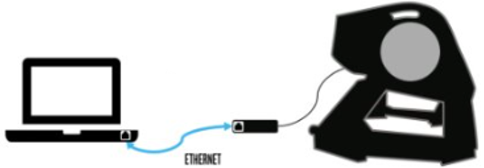

Ethernet direct connect (Network Adapter to computer)
direct connect to ehternet step 1
 Blinking yellow continuously

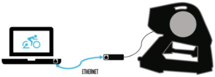

 Connected computer has started training
connected to pc and app for training
Solid yellow
