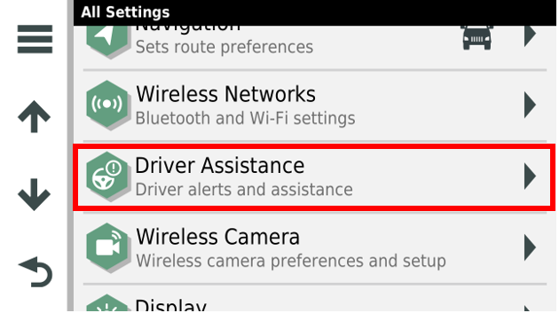

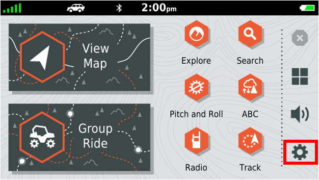

 1. Touch Settings
2. Touch Driver Assistance
3. Touch the box next to Reduced Speed Tone
    • A checkmark indicates the feature is enabled
    • Touching the box again to remove the checkmark will disable the feature
