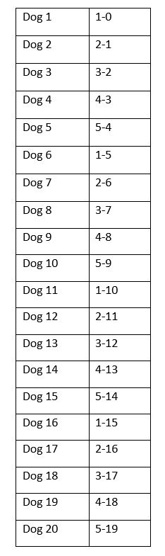

Tracking 20 Dogs
Your handheld has its own ID number. If you are not going to track another handheld, you are able to turn this feature off to free an ID Number for a dog collar, for you to pair 20 dog’s total. You will now be able to add a 20th dog to your dog list. Refer to the above section "Changing the Dog ID and Handheld ID" for the instructions on how to turn off your handheld's ID number.
Example of Handheld With 20 Dogs
20 dogs on handheld

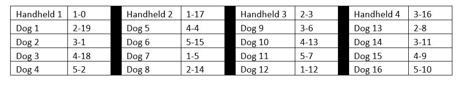

Scenario 1:
4 hunters each have 4 dogs, each hunter wants to track all dogs and all handhelds being use.
Example of  Initial Handheld Set Up

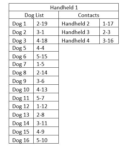

Dogs and Handheld Tracking
Once each dog and handheld have their own ID number the hunters can share the track/control code or share each dog collar wirelessly to the other handheld for them to be able to track as well. Each handheld will have 16 dogs listed in their dog list and 3 contacts listed in their contacts. Your own handheld will not be listed in contacts on your handheld.
Example of Finished Handheld Set Up
16 dogs
