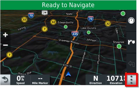

To Enable Trip Data:
1. Touch View Map
2. Touch the menu button or rv1095 menu lines in the lower right corner
3. Touch Trip Data
Additional data fields will appear on the right side of the screen. You can customize these by touching any one of them, then touching the + icon next to the desired data type, which will automatically change the type of data displayed.
