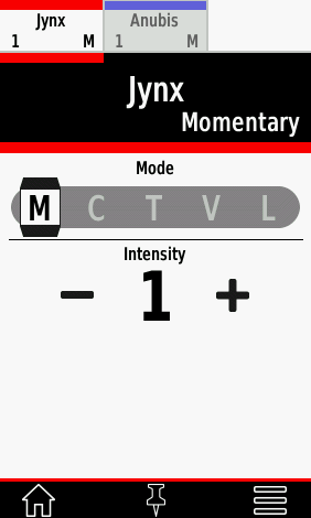

You can customize your training buttons to One Per Dog or Three Per Dog configuration. One Per Dog layout will simplify the training commands to one button for each dog. This can be a better layout when a lot of dogs are being tracked and trained at once. The Three per dog will setup three buttons for each dog, this layout is better used when focusing on training. The Three Per Dog layout is the default layout to change the button layout follow the steps below.
  1. From the Main Menu select Training Setup.
  2. Select Training Defaults.
  3. Select Button Layout.
  4. Select the layout you would prefer.
When using the One Per Dog layout you can quickly adjust the training command from any where outside of the setup menu.
  1. Select the training box you want to adjust.
  2. Adjust the slider to the command you want.
  3. The button is now adjusted.
