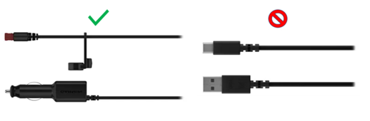

- Make sure your device is plugged directly into your vehicle with its original Garmin power cable.
Do not use a splitter, USB, or third-party cable.
Ensure the 12 Volt Vehicle Power Cable is securely connected to the Locking Magnet assisted Mount.
A replacement 12 Volt Vehicle Power Cable can be purchased if necessary.
