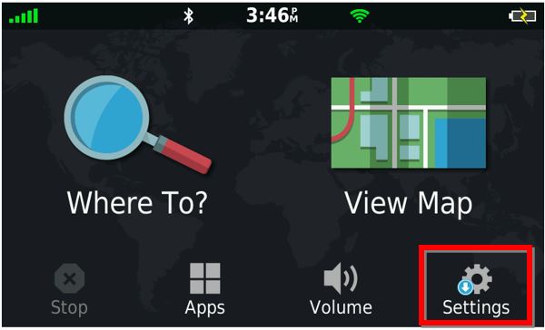

1. From the main menu, touch View Map

1. Touch Settings

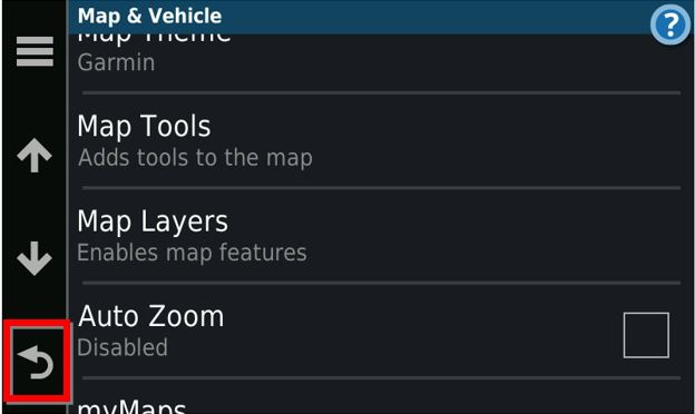

2. Touch Map & Vehicle

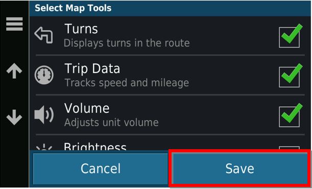

3. Scroll down and touch Map Tools
4. Touch the box next to Trip Data to enable it
    • Trip Data is already enabled if a checkmark is in the box
5. Touch Save

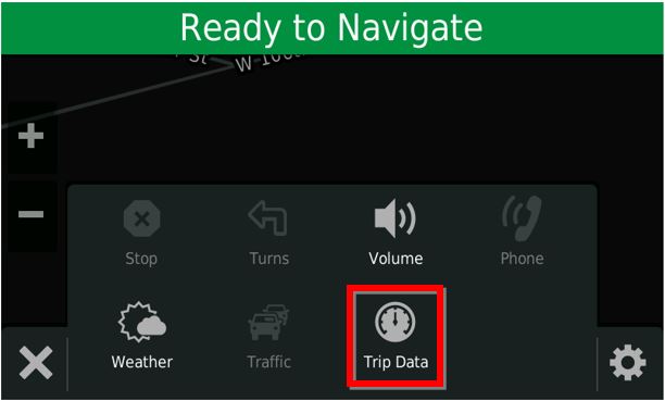

6. Hold down the back button
7. Touch View Map
8. Touch the  wrench or  bars in the lower right corner
9. Touch Trip Data

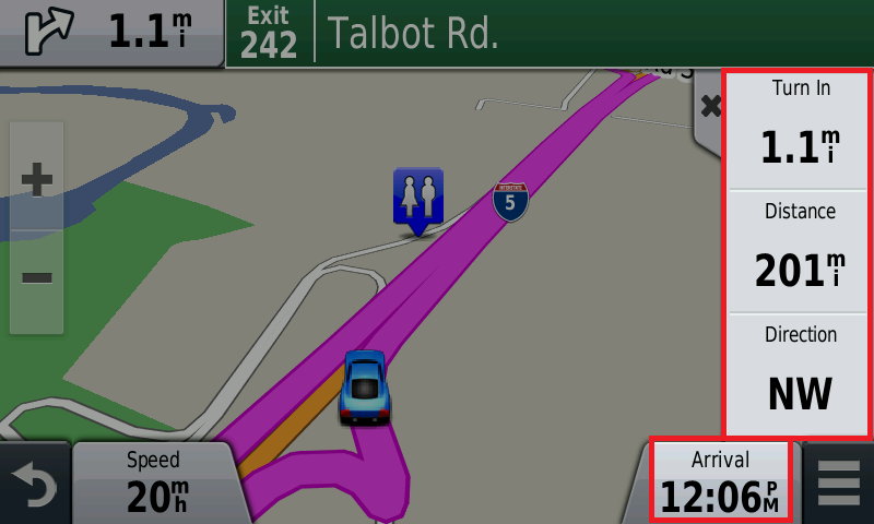

Three additional data fields will appear on the right side of the screen. You can customize these by touching any one of them, touching the + icon next to the desired data type, then touching the  back button.
