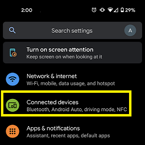

      1. Open Settings on the phone and select Connected devices
        Select Connected Devices

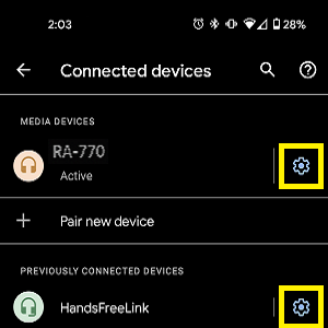

      2. Select the Gear icon next to the device to be removed
        Select Gear

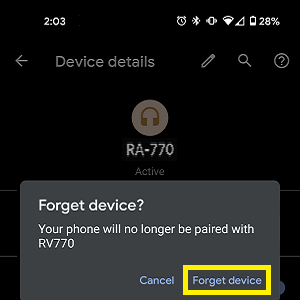

      3. Select Forget
        Android Select Forget
      4. Select Forget Device
        Forget Device
      5. Repeat steps 2-4 for each device under Connected Devices and Previously Connected Devices

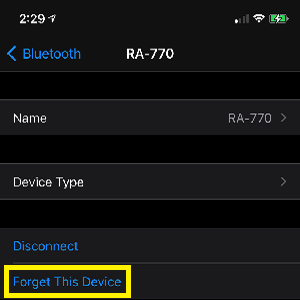

To unpair Bluetooth devices from an iPhone

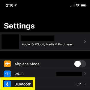

      1. Open Settings on the phone and select Bluetooth
        iPhone Settings

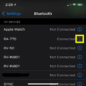

      2. Select Information on the device to be forgotten
        Select Information
      3. Select Forget This Device
        Forget This Device

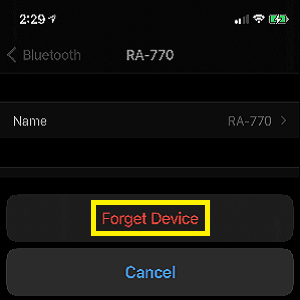

        Forget Device
      5. Repeat steps 2-4 until all devices under My Devices have been unpaired
