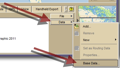

  1. Open XMap program.
  2. Click the Map Data tab.
  3. On the right-hand side of the tab click Data and then click Base Data or Data Locations.

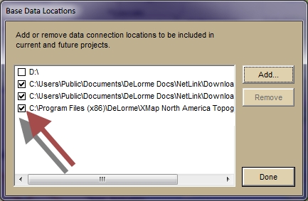

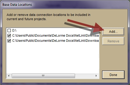

  4. If the XMap Topographic data is already displayed in the Base Data Locations window, skip to step 6. If the XMap Topographic data is not displayed in the Base Data Locations window, click Add.
  5. In the Browse for Folder dialog box select the hard drive location where you saved your data and click OK. The default location for the XMap Topographic data to be installed on a 32-bit operating system is:
    C:\Program Files\DeLorme\XMap North America Topographic Data
    The default location for the XMap Topographic data to be installed on a 64-bit operating system is:
    C:\Program Files (x86)\DeLorme\XMap North America Topographic Data
  6. Click the box next the XMap Topographic data to deactivate the data and then click the box again to reactivate the data.
  7. Click Done. The XMap Topographic data should be displayed in the XMap software.
