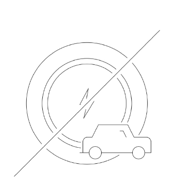

NOTE: Upright wireless charging stands (such as those intended for smartphones) or automotive wireless chargers (such as those built-in to vehicles) may not be compatible.
Image of stand up wireless charger which will not work with Garmin products.Image of line drawn through wireless charger and a car.
