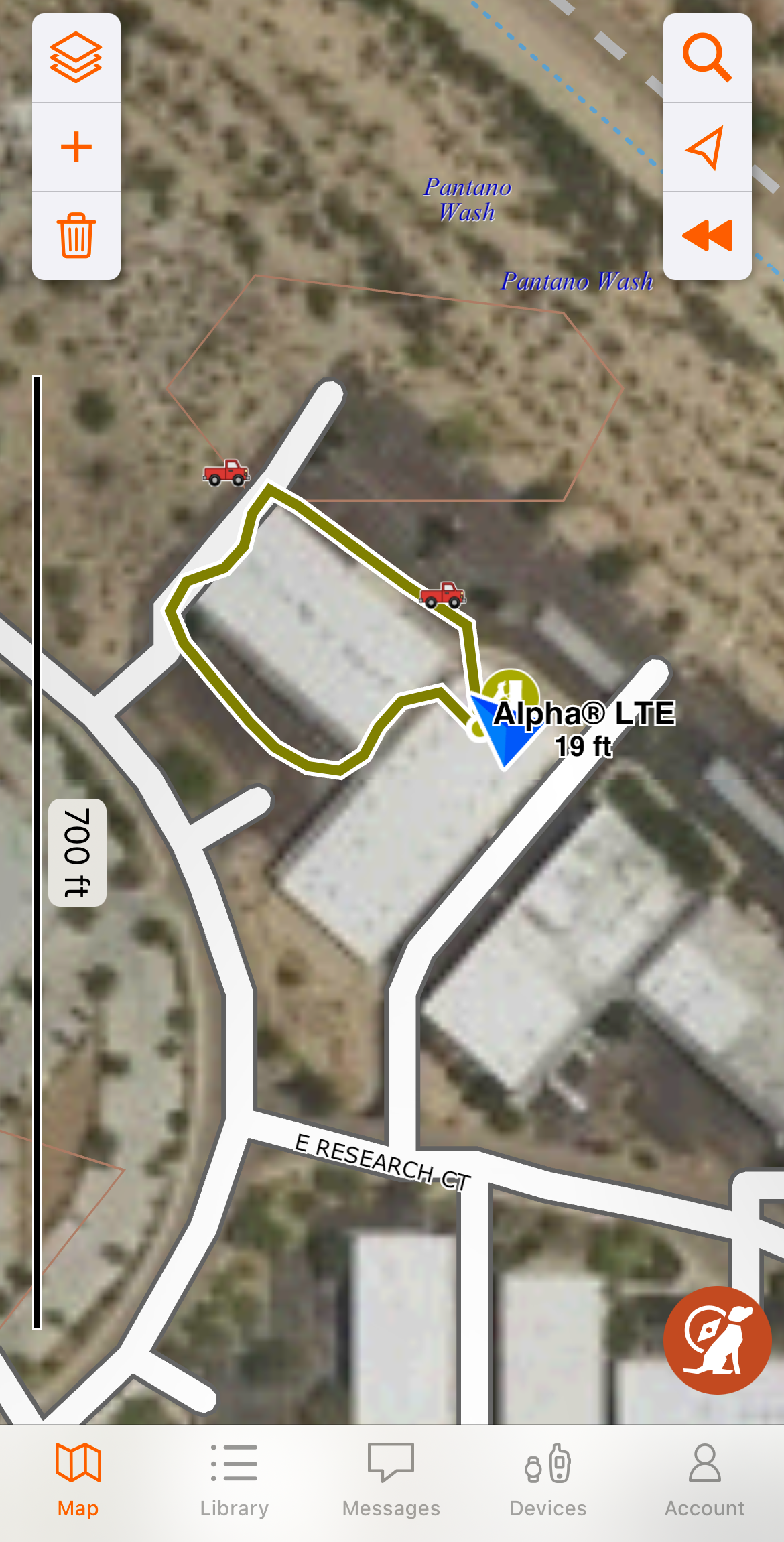

There are two options for tracking in the Garmin Alpha app using the map to view track detail or through the Pro View shows direction and distance.
Tracking from the Map
Once the Alpha LTE is connected and has picked up an LTE signal tracking information will automatically show on the map page see the example below. There are also different settings you can use to edit the track.
Alpha LTE track
