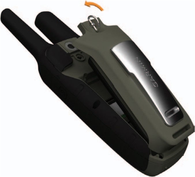

Lithium-ion Battery Pack Installation
  1. Align the metal contacts on the battery pack with the metal contacts on the back of the unit.
  2. Gently press the battery pack into place.
  3. Turn the D-ring clockwise.

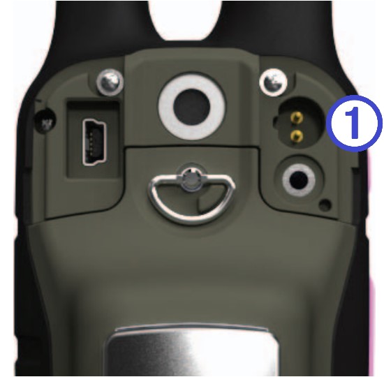

Charging the Lithium-ion Battery
Charging a fully depleted battery takes 6 hours. The device will not charge when outside the temperature range from -4°F to 140°F (from -20°C to 60°C).
  1. Plug the AC charger into a standard wall outlet.
  2. Lift the weather cap.
  3. Plug the small end of the AC charger into the two-pin connector one.
    Location of Charging Pins
  4. Charge the device completely.
A fully charged battery can run for up to 14 hours before it must be recharged.

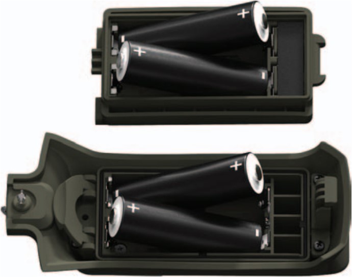

Installing AA Batteries
Instead of the lithium-ion battery pack, you can use alkaline, NiMH, or lithium batteries. This is especially handy when you are on the trail and cannot charge the lithium-ion battery pack. Use NiMH or lithium batteries for best results.
NOTE: Use of AA batteries requires an Alkaline Battery Pack (sold separately).
  1. Turn the D-ring counter-clockwise, and pull up to remove the cover.
  2. Insert four AA batteries, observing polarity.
    AA Battery Pack
  3. Replace the battery cover, and turn the D-ring clockwise.
  4. Update the battery type in the system settings:
    1. Select Setup > System > Battery Type.
    2. Select Alkaline, Lithium, or Rechargeable NiMH.
