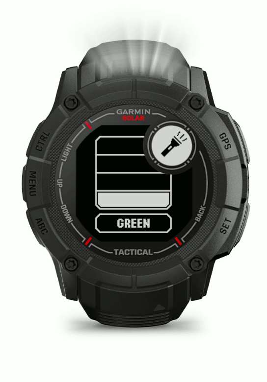

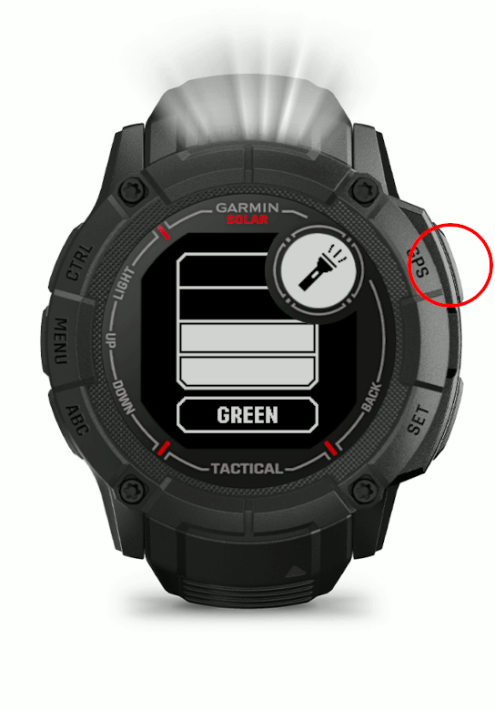

    Brightness Levels
    Press UP or DOWN to adjust the brightness level.
    Flashlight Brightness Levels
    Green Light
    Press UP or DOWN until GREEN is selected.
    Flashlight Green

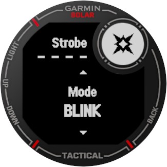

    Strobe Light Settings
    Press and hold UP/MENU, then select Strobe and choose an option:
    • Blink - The symbols at the top of the display represent the strobe pattern behavior.
      Strobe Blink Mode

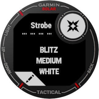

    • Custom - After selecting the Custom option, select Pencil Icon to choose the light pattern, speed, and color. The symbols at the top of the display will represent the strobe pattern behavior.
      Strobe Custom Mode
    • Blitz - The symbols at the top of the display represent the strobe pattern behavior.
      Strobe Blitz Mode

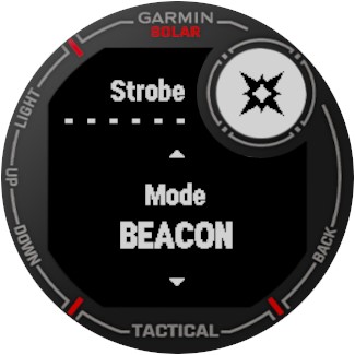

    • Beacon - The symbols at the top of the display represent the strobe pattern behavior.
      Strobe Beacon Mode
