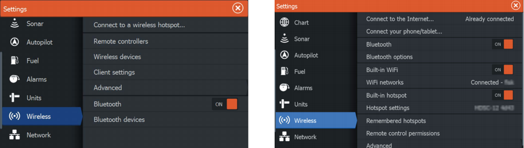

What to Do if the Plotter Will Not Connect (Navico)
Be sure that your device is in Access Point mode.
Navico Wireless menu showing in Access Point mode
Depending on your plotter, your Wireless Settings may look similar to one of the screens above.
  • Your plotter's "Built-In" or "Internal" wireless needs to be turned on to throw out a Wi-Fi signal.
  • Your plotter must be in Access Point mode. This means you should see "Connect to a wireless hotspot". If your plotter says "Change back to an access point", select this option and then confirm by tapping Yes.
  • If your plotter has the option to "Connect your phone/tablet", choose that option to make the plotter Wi-Fi visible on your device.

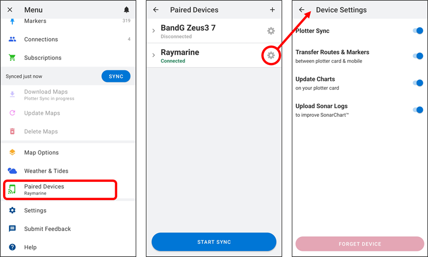

Navigating the Paired Devices Menu
This is the area to manage devices and initiate Plotter Sync multiple times should there be a need to sync throughout the day while the app is running and connected to the MFD.
  • Paired Device Settings control the contents transferred between the Boating app and your chartplotter.
  • Deciding what to transfer can be desirable as chart updates may not be required with each sync.
  • Turn off the feature altogether or turn off individual options within the feature from the menu.
Available sync options for paired devices in the Navionics Boating app menu.

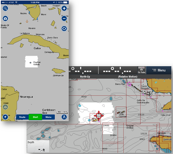

Why Are All My Charts Not Loaded to My Plotter Card?
In this example, the updated area (bright) does not match. This is because the Boating app coverage is all of Mexico and the Caribbean, while the card coverage on the plotter does not include Central America.  Red chart boundaries on the MFD screen indicate the card coverage.  As a result, updates transfer occurred within the chart coverage only.
Mobile app and plotter screen showing the downloaded coverage and it differs slightly
Back to top
