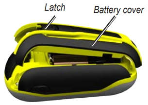

  1. Slide the latch and remove the battery cover.
    Battery Cover
  2. Insert the battery. Align the positive and negative markings on the device with the battery.
  3. Replace the battery cover.
