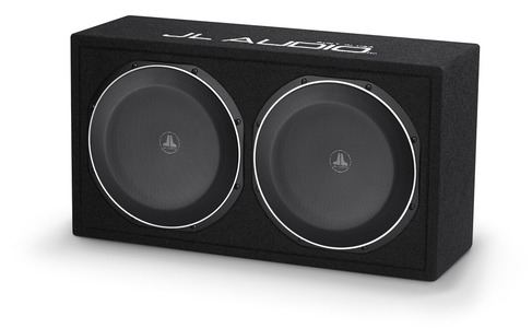

JL Audio subwoofer box
Subwoofer seems muddy or lacking in detail, impact, or output
  • Check the level balance between the subwoofer system and the satellite speakers. If the bass level is too high the midrange can seem low or the bass undefined and muddy.
  • When using a ported enclosure make sure subwoofer enclosure's tuning is not too low. This can compromise upper bass range and the transition with the midrange speakers. Double check with the manufacturer for suggested tuning.
  • Make sure the enclosure is of rigid construction, built to the manufacturer’s recommended size, and secured to the vehicle. If the enclosure is loose, bass energy will be lost since the enclosure will move when the subwoofers play and acoustic energy will be wasted.  Read more on Securing Your Subwoofer Enclosure.
  • Try facing the subwoofers different directions to see if impact or output improves.

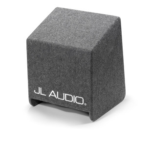

JL Audio down fire box
  • In many convertible vehicles, a down-firing subwoofer enclosure works best. This maintains a good loading effect for the bass frequencies, even with the top down. Oftentimes, if the enclosure were to point up, back, or forward in a convertible you would not have the added benefit of the loading effect, leading to a good amount of  bass escaping into the open air while the vehicle is moving.
