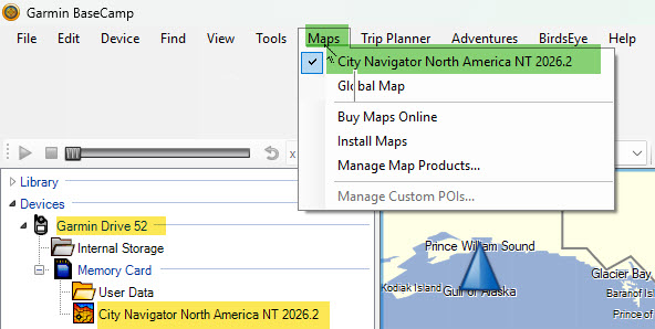

Before Creating your Route(s), Verify that BaseCamp is Using the Same Map Version as the Connected Device
To Find the BaseCamp and Device Map Version
To Verify the Map the Connected Device is Using:
  1. Connect the device to the computer.
  2. After BaseCamp displays the name of the device, click it to see which map version it has installed.
In the example highlighted in yellow above, the Garmin Drive 52 is using City Navigator North America NT 2026.20.
 To Verify the Map Version BaseCamp is Using:
  • The selected map version on Windows will appear with a checkmark next to it when you click Maps in the menu bar.  It can also display in a drop-down menu above the map window.
  • The selected map version on Mac will appear with a checkmark next to it when you click Maps in the menu bar.
In the example highlighted in green above, BaseCamp is using City Navigator North America NT 2026.20.  If Global Map or any other map is checked, select click City Navigator North America NT 2026.20 to ensure both BaseCamp and the Garmin Drive 52 are using the same map.
