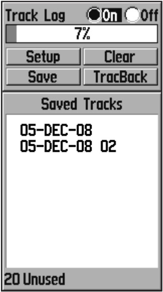

eTrex Tracks Page

Saving the Current Track Log
  1. Press Menu/Find twice to open the Main Menu page.
  2. Use the Thumbstick to highlight 'Tracks' and then press it in to select it.
  3. Use the Thumbstick to highlight 'Save' and then press it in to select it. Select 'Yes' or 'No' when prompted with 'Do You Want To Save the Entire Track?'
    • If you select 'Yes,' a 'Saving Track' message appears followed by the Saved Track Page. The new saved track is a representation of the entire track log from beginning to end.
    • If you select 'No,' a map showing the entire track appears. Follow the prompts to select the beginning and ending points for the track by using the Thumbstick to move the panning arrow and select the desired points on the map.
  4. A 'Saving Track' message appears followed by the Saved Track page. Use the Thumbstick to highlight and select 'OK' to save the track.
The track is now saved in the 'Saved Tracks' list on the Tracks page.
