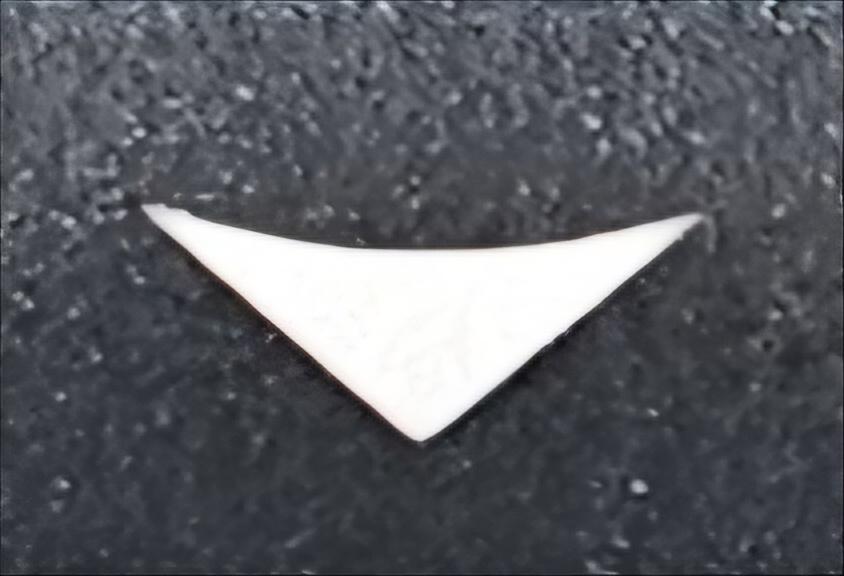

- Verify the GNX™ Wind instrument wireless connection is OFF if no data appears on the GNX™ Wind instrument
- Press
> Press
until 4.0 SENSE appears > Press
> if ON press
and ON will blink > Press
and OFF will display > Press
to accept the choice

Verify the GNX™ Wind instrument wireless connection is on
If the wireless antenna symbol is missing from inside the wind rose on the GNX Wind, turn wireless feature to on:
Press> Press
> if OFF press
and OFF will blink > Press
and ON will display > Press
