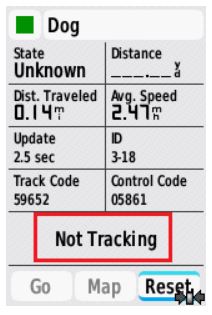

The collar location should now display properly on the Astro 220 or 320 handhelds.
Dog information page with red box around update rate

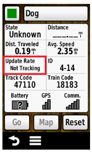

The collar location should now display properly on the Astro 430 or Astro 900 handhelds.
Dog information page with red box around not tracking

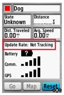

The collar location should now display properly on the Alpha 100 handheld.
dog information page with red box around update rate

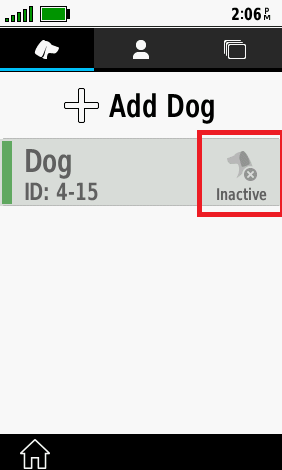

Alpha® 200, Alpha® 200i, Alpha® 200 Plus, Alpha® 300, or Alpha® 300i Handhelds
  1. Tap Dog List from the main menu
  2. Tap the Dog you want to Activate/Deactivate tracking for
  3. Tap the Active slider
Alpha 200i add dog page with red box around inactive
